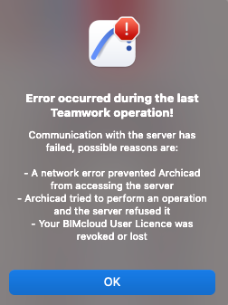

During work on a TW project I got this message when sending changes:
Error occurred during the last Teamwork operation!
Communication with the server has failed, possible reasons are:
- A network error prevented Archicad from accessing the server
- Archicad tried to perform an operation and the server refused it
- Your BIMcloud User Licence was revoked or lost
I can receive changes, I checked network diagnostics and BIMcloud is accessible, I haven't lost or revoced my licence...
So what do I do now???
Mac OSX 13.6.6 | AC 27 INT 5003 FULL

I'd prepare a Teamwork Support Package (see Creating a Support Package ) and reach out to the local support. If you can receive with no issues, but can't send, it means you either have corrupted data, or you might have modified something that was reserved by another user. You might go ahead and save a pln and just re-join the project and copy-paste your changes, but if the data is corrupted, it's very likely to end up on technical support anyway.
Noémi Balogh
Senior Community Expert, Admin
In our office (Windows) the go-to solution for teamwork problems is clearing the local TW data on the client.
If this doesn´t help the problem is severe, in >90% it helps.
