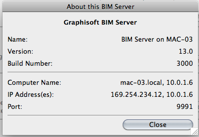

Hello I updated AC to the latest version AC13-3600 and after that, I installed (from the CD) and configured the BIM server in my computer to start working in team work with my boss.
Some how the BIM server built number is 13-3000 and I am not being able to start the sharing process. Any idea how can I do to update the BIM server to 13-3600?
3 Replies 3
You have to run the build 3600 update (hotfix) again on the machine that has the BIM Server to update it. Obviously, the CD has the oldest possible version of everything. The hotfix updates three things: ArchiCAD, BIM Server and BIM Server Manager.

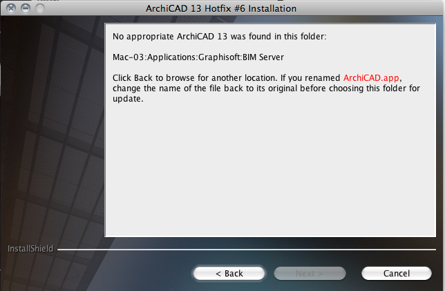

Yep, tried that but the hotfix won't go thru because it says AC13 is already update.
It gives me the opportunity to browse for an other AC to be updated, so I browsed for the BIM Server but it doesn't work. It only accepts to update ArchiCAD.app

If you click through the option to upgrade ArchiCAD you will notice that the next screen will inform you that the BIM Server is going to be upgraded automatically.
