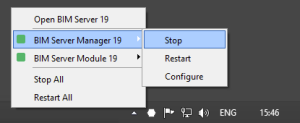

  • Using the BIM Server tray icon.

Start and stop BIM Server using the BIM Server tray icon
From version 19 there is an application named BIMcloud Monitor which helps monitoring and managing the BIM Server's services. When this application is running the BIM Server tray icon appears in the Menu bar/Taskbar which grants quick access to manage the BIM Server's services. To control the BIM Server's services click/right click on the BIM Server tray icon in the Menu bar/Taskbar. In the pop-up panel it is possible to start/stop/restart all services at once or one by one.

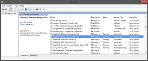

Start, stop, restart services
In order to control the services open 'Services':
  • Type either in the run prompt or in the Windows interface's (Start Menu's) search field: services.msc
  • The same settings can be accessed through the Computer Management (Services and Applications/Services)
There you will find a list of all services. The BIM Server runs if the previously mentioned services are running. Each service can also be started, stopped and restarted here.

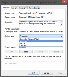

To control whether the BIM Server is automatically started with the computer
  1. Select the service on the list
  2. Right click and select Properties
  3. Startup type - change it to Manual
  4. Repeat this with both services
If the services are set to start manually, you will need to start them each time the computer is rebooted. The best is keeping these settings on automatic, but in some situations the manual setting may be useful:

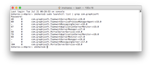

How to list all running GRAPHISOFT services (daemons)
In order to list all running daemons, a terminal command named launchctl needs to be used with list parameter. The following example will list all GRAPHISOFT related daemons:
  1. Start Terminal. It can be found in /Applications/Utilities/ folder.
  2. Type the following command: sudo launchctl list | grep com.graphisoft
  3. Enter.
 Using the sudo command in Terminal asks you to enter your administrator password. You will not see the password as you type it, this is normal. If you enter the wrong password, Terminal asks you to try again. How to start the BIM Server In order to start a daemon, a terminal command named launchctl needs to be used with load parameter. The following example will start the 19 version daemons (change the version number in the .plist file name in case of other versions):

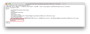

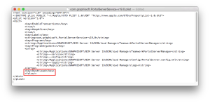

  • Navigate to the folder of the LaunchDaemons (System drive/Library/LaunchDaemons) in Finder.
  • Drag and drop the .plist files to your desktop (otherwise you will not be able to save the modifications).
  • Open the .plist files in a Property List Editor or in any text editor.
  • Change the RunAtLoad to No (Property List Editor) or change the RunAtLoad key to false as on the pictures below.
  • Drag and drop the files back to the original location (authentication will be required).
