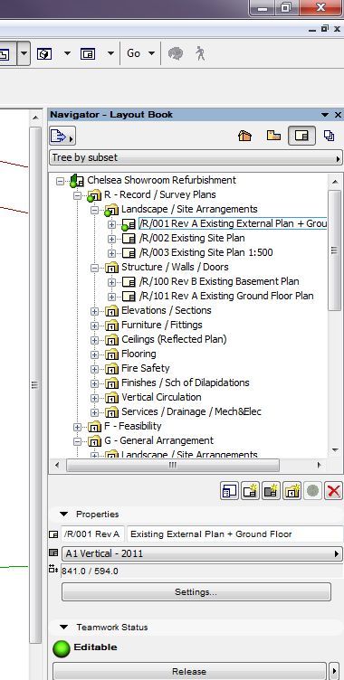

We have an ongoing problem which is becoming a real nuisance. I am sure it is something to do with having the correct combination of reservations/drawing ID subset settings.
Demo of our drawing number system; 1107/R/001
1107 = Job Number
R = Means Record/Survey Drawing
001,002,003,etc = Drawing Number
[see jpeg]
In the layout book the field which contains the drawing number "/R/001" and so on, will not remember alterations after closing a teamworks file and then reopening.
The way our drawing revisions work, we manually enter "Rev. A" or "Rev.B" etc after "/R/001". Teamworks will not remember changes to the "Rev" and reverts back to an earlier entry. So we have a situation where even though as far as we are concerned we might have previously published "Rev. E" of drawing 1107/R/001, teamworks will continue to reload 'Rev A'!!
I hope that makes sense?
Notes;
-The reason why we include the "Rev" number after the drawing number is so that when the drawing is published, the revision number appears in the file name (PDF & DWG).
-I have tried reserving drawing>subset>subet>layout book, all the way up the tree and then making changes with no success.
-Interestingly, I have also tried changing the setting of a subset folder and how it auto ID's drawing numbers - following a close/open - the setting had reverted back to auto numbering instead of "do not include this layout in the ID sequence".
-I can make changes to the drawing name fine. It remembers alterations after a close/open.
HELP! I am wasting hours cross referencing what revision number we are ACTUALLY on compared with what revision teamworks still THINKS we are on!

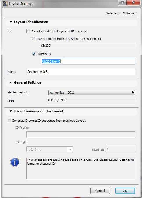

To add to Dans comments, below is the layout setting used.
The initial layout ID is automatically changed in-line with our file structure and then we can the ID to custom to input the Revision note.

Dear Dan,
this observation is a known issue with Custom IDs modified in Navigator which is scheduled to be fixed in the next ArchiCAD 15 Hotfix.
At the moment I recommend to change the Custom ID in Layout Settings dialog which modification can be correctly saved or sent in Teamwork.

Katalin,
Thank you for your reply. Updating the Custom ID in the layout settings dialogue box is working fine for us in the interim. Look forward to the hotfix.
