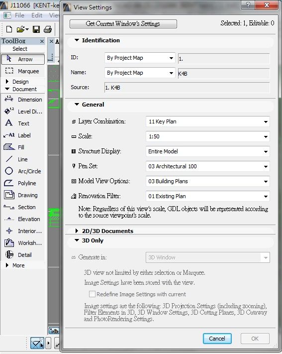

I am new to the teamwork. I make a server and make myself as the lead Architects with full control power. After I set one project, I want to change the settings of some drawings.
However the "OK" button is grey. I could not confirm the change of this teamwork archicad.
3 Replies 3
Make sure all the check boxes are checked in the Access Right for the Lead Architects Role, in Role Settings. Also make sure you have Server Administrator and Project Administrator checked in User Settings.
If you have reserved the drawings and it's still not working, I'm stuck to suggest anything else.
In the Navigator first right click and reserve the View you want to modify the settings of.
Thanks for your tips. All the objects and drawings should be reserved first for further work.
