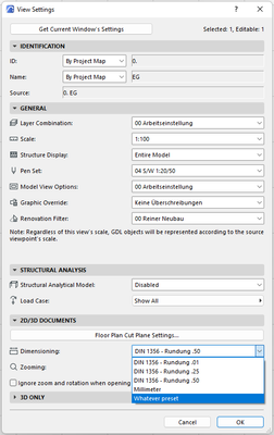

Hello everyone,
We have 4 bigger projects at the office and we are only 3 users.
For some reason each time we join a TW project the dimensions settings is switched to some silly swedish standard called DIN, which we never use nor have ever used before.
I'd say all 3 of us are decent Archicad users (but we have not been using TW much before, small office) but can't seem to figure out why the project preference standard is changed back when we release and join again.
I have been doing some research and another tread about this said something about changing the setting, all users have to leave, change avatar and colour for the setting to kick in. This can't be the solution.

Andrii Levko
Hi Felix
I assume you're talking about switching dimension settings in the project map?
If you are using a View Map, the dimension settings will not switch, it should always be as you set in View settings >> 2D / 3D Documents.

Miha_M
As @Andrii Levko said, you should save your desired Dimensioning settings and appy these scheme to your View Settings (View Map > right click on the view > View Settings > set Dimensioning). Do the saved views change their settings after somebody joins the TW project?

Frillex
Hi Miha & Andrii,
Thanks for your replay.
The views are saved as they should, with our dimension setting we usually use.
So when ever I change to an existing view the setting changes correctly.
This happens when ever someone leaves and enters again. And that's what I'm trying to understand. Does this have something to do with our settings when the project was saved as TW file?

Frillex
Just to clarify:
It's only set to DIN when I'm in the project map as I join.

Solution
Andrii Levko
I can say for sure that it depends on what dimension settings the file was shared with on BIMcloud. It has been tested in practice more than once. So if the file was shared with the DIN settings in the project map, then when a new user join, DIN dimension settings in the project map will be by default.
Solution might be to reshare the project. But in my opinion it is not needed since you are using the view map.
Andrii
