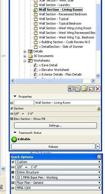

I have attached an image showing the section in view map, the designated settings, and the actual settings after double-clicking on it. Please note the exclamation icon next to the layer combination. When hovering my cursor above it, it said "The settings in the frontmost window no longer correspond to the original view settings." No view settings were modified after double-clicking on it. Hopefully this could be discovered and corrected by those who need to know about it. Thank you.
