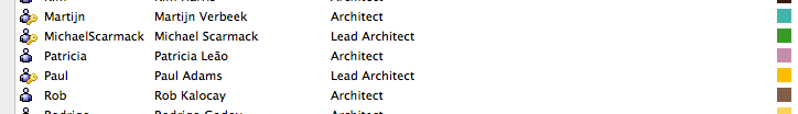

Michael
Paul has Super user status ... see screen shots.
Michael |:-)

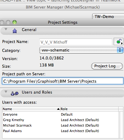

Michael
Paul- Lead Architect 2--see attached screen shot
