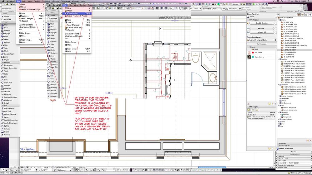

How or what toggle/button whatever I have to activate to make this one user in our team be able to "CLOSE PROJECT"?
I've asked her not to "LEAVE" the project database since leaving it is not good.

rob2218
This teamwork project came from an IFC file.
there was no migration from 13.
How do I get the "close" or "close project" back on the "FILE" drop down menu? it's the weekend coming up and we shut down the computers and I've told all users not to "LEAVE" the project but quite frankly I have no other option. We don't leave the computers on as a policy for the weekend so what do I tell this user???

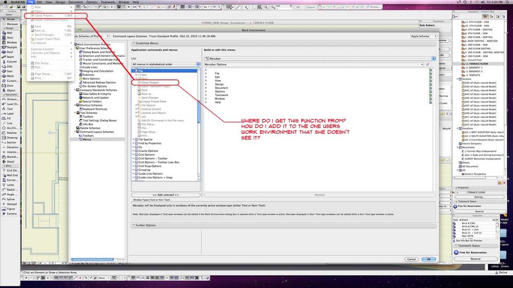

Rob:
You can modify the Work Environment > Command Layout Schemes > Menus, remember to Redefine the scheme or save a new scheme to retain the changes. You could create a custom Work Environment to install on all computers in your office so there is one common WE for an office standard.

rob2218
David,
where would I get the "close project" or the "close" (which ever the case may be) function from?
From which other menu do I acquire this icon and function to drag into the "FILE" menu?

rob2218
David,
here's the screen I see on MY machine, but on the other users....I can't seem to locate where throughout the other menus can I grab the "Close project" or "Close" command and drag it into her "FILE" menu....

On the right side double-click the File menu to enter it.
Then the items on the left will become enabled and you can drag it to the right or click the "Add Selected" button.
rob2218
thanks all.
I spoke to David here locally.
He was able to walk me thru exactly what Lazslo was stating.
again...thanks all.
