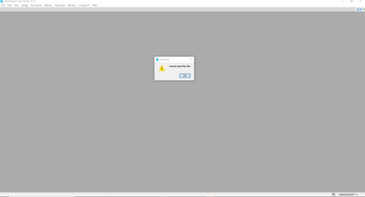

"Warning! Cannot read file plan."
jetthvn
Hello, I was wondering if anyone has a fix for Archicad not allowing you to open shared downloaded files. Files shared between myself and the company architect will allow him to open the same file that I cannot. I have the most recent software update and all the same hardware specs as him. Would anyone know what to do to fix this? Below is a picture of the message I receive:
19 REPLIES 19
All the file is storage at own PC, we never subscribe cloud storage before. We had restarted many times is still the same. Other files have no problem to open them, only this "Oil Mill Office_231206_R6" file, which we first time insert the MEP ductwork to this project. If we click to the "open as Read-Only". then it will appear " unknow document version"unknow document version.jpg
we also had tried to "launch at new instance of ArchiCADcannot read plan file.jpg", then it will show "cannot read plan file."
The unknown  version message will appear if the file had been saved from a newer version of Archicad than the one you’re now using.  Newer versions… through 26 can open any old version file back to 8.1.  Starting in 27, it can only open files back through version 25.

We had ArchiCAD version 24, 25 and 27, we had tried all of them. None of them can open the file. We had also emailed the file to local dealer to try to open it, but yet to receive any feedback.

As there is no version number in your image, I think the file may be corrupt, or it was saved in a newer version.
But there is nothing newer than version 27, so that makes me think the file is corrupt.

Yes, the PLN. file was corrupted, so as the BPN (backup) file is also corrupt too. We had tried to open a new file and merge too, but it did not work either. Meanwhile we had also used Archicad version 25 and 27 to open it. but it shows the same result.

A corrupt object or something interfering with downloading the file, there can be various reason why a file might be corrupt. From the attached picture I can see it still has a lot of information in it. It might be worth to check it's hex codes (you can check it from https://hexed.it/ or if you don't want to do it from an online source you can download Double Commander). Generally, if you see a lot of 0's at the beginning or at the end, that is the most serious data loss, so it would worth to send your file to Graphisoft to be fixed).

We try the  it from https://hexed.it and checked the hex codes as per attachment, We had also contacted the local technical support, but had reply is the file is not repairable. 😭
Oh, sorry to hear that. If development says it's not repairable, I don't think you can do anything about it. I would suggest to request the same file from architect who sent it. Maybe they can Open&Repair the file on their side, resave it with "save as..." and send you again. (and/or merge it to a new Archicad file just like how it's suggested to you, save as and resend it).
