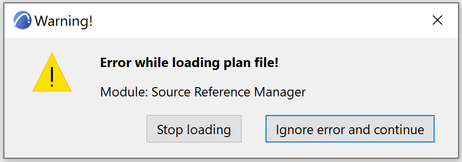

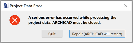

    • Archicad displays many warnings while attempts to repair the file. Messages appear like:
    • Cannot read Plan file:
The file you are trying to open is damaged:
  • Do you want Archicad to try recovering it?
  • The project is empty
    • Archicad succeeds in opening but the project is empty.
  • "The file cannot be opened"
    • Archicad fails to open the file, bringing up an error message "The file cannot be opened".
      See also: Error messages. Messages appear like:
      - "Error While loading plan file!":

Solution
What to do when data loss has occurred:
  • Open and Repair
The Open and Repair process works for PLN files only. If your project is a Teamwork project see note below*.
1. Launch the Archicad application from the desktop shortcut, dock, start menu or application folder.
2. When the Start Archicad dialog appears, choose Open a Project,  Browse for a Solo Project and click Browse OR go to File > Open > Open.
3. IMPORTANT: Go to the file location and click on the file ONLY ONCE so that it is highlighted.
4. Now put a tick mark in the Open & Repair Selected file checkbox in the lower right corner of the dialog.
5. Then open the file and wait.
6. After a time the file will report either that the project was healthy or that it was repaired or that the file cannot be repaired.
* If your project file is a Teamwork file, first go to File > Save As… Format/File Type: Archicad Solo Project .PLN, then perform the steps 6 above. If the Repair option fixes the issue, you should re-share this PLN, have other users Join this new copy of the project and continue working from there.
