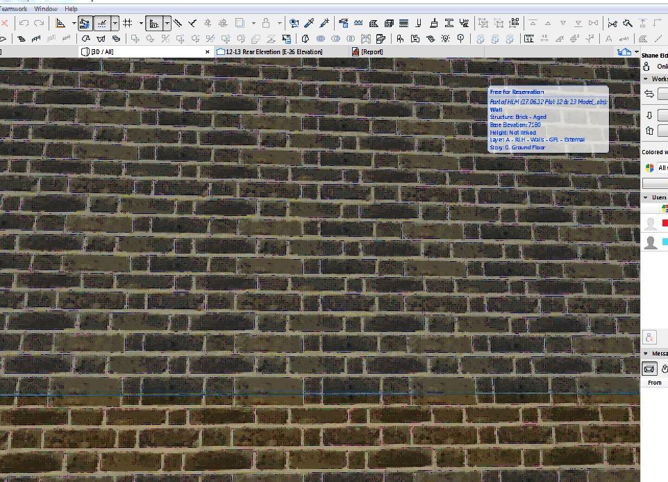

Hi guys,
I'm working on a project, and the external finish is a brick, but where the ground floor and first floor meet, the brick stops, and starts again, but i want it to flow nicely all the way to the top. i have added an image of what i mean. if you guys could help that would be amazing. thank you!
2 REPLIES 2
alemanda
select the surfaces and set the texture origin in the same point.
In order to set the texture origin go to Design/Aligh texture3D/Set origin. This is under AC19
