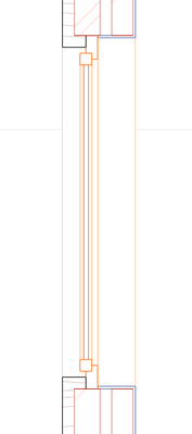

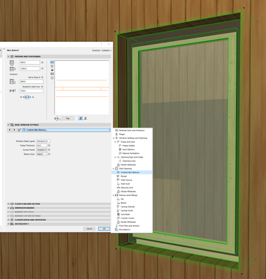

Hi all,
I was messing around with an object that you could place over a window to wrap the wall skins in 3D a while back, and just figured out how to insert the default window library into it. Just posting it here if anyone wants to take a squiz at it. It seems to work fine with the basic AUS windows, but the UI needs to be manually toggled between the window types.
Ling.
ps. Why do the GDL and Opening labels appear in the tag list on the Document & Visualize sub when I cannot use them in a post here...
pss. Hm... I appear to have broken the sectional materials... they are not joining with the wall ones...

Hi Ling, I am stumped trying to figure out what the purpose is for having the wall cladding appearing right behind the window pane ? Hmmm ?
I have a house with some high level windows where the stone interior cladding wraps to conceal the frame. So, on the odd occassion in which you want to hide your frames, but don't want to do floor to ceiling? You should be able to toggle it off. Or did I break that just before I posted it here?

ps. I does seem like I broke the wido_reveal_side = 1 but that has been fixed.
mthd
When internal stone cladding wraps around the internal window reveals ?
