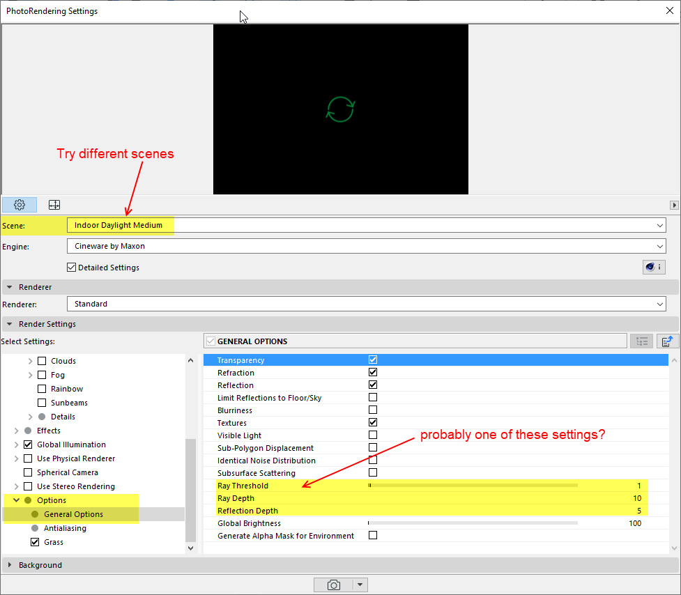

I am pretty sure it is a rendering setting and not a modelling problem.
Just don't ask me what settings as I don't do enough renders to remember.
Try using different scenes to see what the effect is.
If I had to guess it would be something to do with ray threshold or ray depth - it usually seems to be those that have the most affect.
Thanks, Barry, will try those changes and let you know.

Found the issue!
It wasn't any of the General settings, however it was very close to that.
As standard, apparently "Use Physical Renderer" was causing the white lines. I've un-ticked the option and now is looking great
Glad you found it.
There is probably a setting or two in the physical render settings that you can tweak as well to fix it.
Or just turn it of as you have done.
The render settings are quite complicated and sometimes it is a combination of settings that can cause problems.
