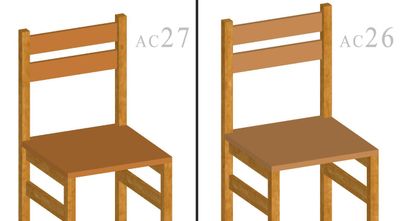

I’m seeing a big difference in the 3d window from AC26 to AC27. In particular, there doesn’t seem to be any antialiasing in AC 27. “3d anti-aliasing (with Hardware accelerated mode)” is checked in both cases. All other settings are also identical.
Is anyone else seeing this?
Maybe there’s some issue with the NVIDIA GeForce RTX 3070 in AC 27?

A restart fixed this. I'm not sure what was going on.

The 3D window needs to be closed and opened for the change to the 3D setting to have effect - perhaps this wasn't done before and the restart did it?
