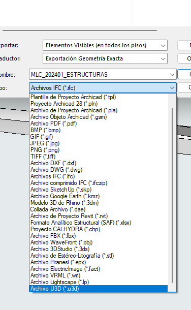

marcoariveross
Hi
Uff, I used that option back in Archicad 7, I think.
I remember the format was U3D. The limitation was that it only opened in Adobe PDF and not in other applications (I don't know if that's still the case).
