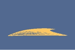

Dwight
I looked up the object that animates an object.
It has three settings - shown below is "rubber" - also "Growth" and "Construction"
The original file is SO_Animation.PLA containing several useful animated objects. It dates from 1999.
Whose is it? Is it commercial? Can we distribute it?
Click the image to see the animation....
