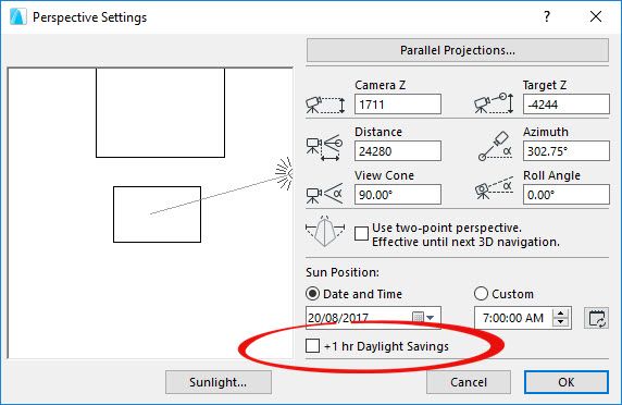

Hi. I wanna export a sun study of my project. the only question is, I need to adjust daylight saving time for the date I am making the sun study but I don't see that option in the settings dialogue box.  So for example for a day in June, I need to set +1h daylight savings to the sun but it seems there is no such option in Sun study settings...

Does setting the option in your '3D Projection Settings' help?
It does adjust the sun position.
If not just add 1 hour to the time of your sun study.
