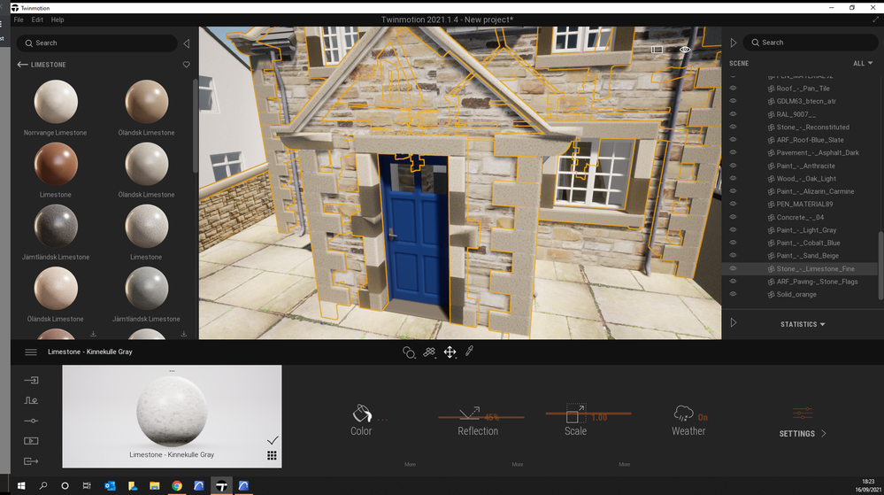

Im currently trying to export my project to Twinmotion and i am experiencing glitches with the lighting on my morphs. The morphs appear to be solidified.
Ive got a screenshot of the issue here
Feedback/solutions much appreciated,
Thank you,
1 REPLY 1
Earthworm
Under export option instead of choosing the standard "merge by materials", choose "no merge"
When importing you fbx into TM choose Collapse "keep hierarchy"
This should work 😬
