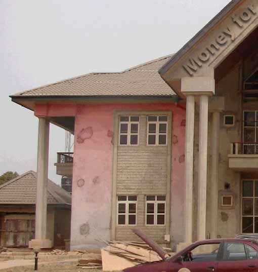

I am currently working on a painting scheme for this project. it was drawn in my pre-archicad days but client wants a paint study to enable make up his mind. The question is this would it be better done in photoshop or would an archicad model do the job? I'm not very conversant with photoshop but I wonder if it would be faster - the AC model is taking much time than expected. or is there a better way to achieve this?

ten minutes in Photoshop.
You lasso or path-define your area selections and place new colors using the "color" blending mode, so that underlying buildling details aren't obscured..
Can't touch that any other way.

If you're just doing the colour scheme then way easier to do it in photoshop - and it's the best way of learning photoshop as well, at least it was for me. there are tons of photoshop tutorial websites - psdtuts.com is a good start.
Definitely Photoshop!

So photoshop it is. Would check out the tutorial website and photoshop express.
..so that underlying buildling details aren't obscured..
I actually want the flat walls to be to covered with opaque paint while the stone tiles retain their relief but not their colour. I hope this can be achieved with photoshop ..easily.

Sure. The usual mode is "normal" - like an opaque paint.
But: you don't necessarily want this even if you want to cover the walls - vary the opacity of the paint to let something show through or the building will not model correctly.

Since Aime wants to try several color variations - does Express or Elements allow saving of all of the different masks for the various surfaces as you might do in the full product (or in Piranesi)? Without that, it could be somewhat tedious to repaint the variations - although I suppose you could just use magic wand on the painting layers. Duh...
Re: opaque - Aime, while you would want opaque to hide the construction issues in the flat walls - if you paint opaquely, you will lose the blend of the shadows...and so will have to repaint your shadows.
