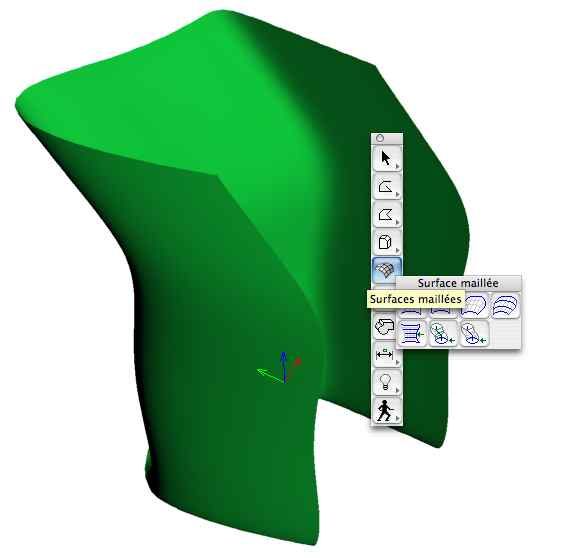

Are you sure you already tried ArchiForma 2.0?
The following image shows something of similar created in not more than 15 seconds...

" is it not true that you cannot edit each surface spline or node individually?"
Partially true!
You can still edit any node (by graphically dragging it) used for the 4 curves definition.
More nodes you will use more editing issues...

Dwight
So your skins are edited from the polyline edges that originally define the surface, but no intermediate points.
This would mean that a user couldn't make little bumps on the surface of the skin, say, unless it was associated with the edge somehow.
This is the reason I said what I did.
