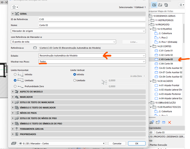

I have a BIM model with some sections, some of them are to be displayed and others are supposed to be hidden.
All of the sections are appearing in the plan, as normal, with exception to one section "C03" that exists in the views but doesn't appear in any plan.

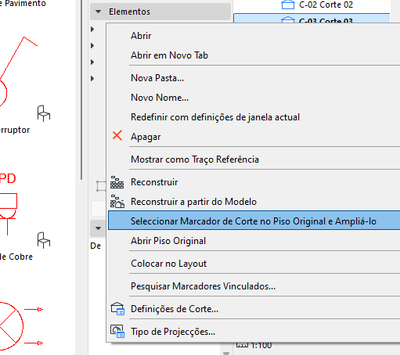

I've already checked if it's not a model build section, but everything is fine. I tried to open using the "select section in the plan and zoom it" but it still doesn't appear.
Does anyone know something about it by a similar situation?
I'm adding some print screens of the settings, they're in portuguese but in the "STATUS: Auto reconstruction of the model; Storys: Show in all stories"

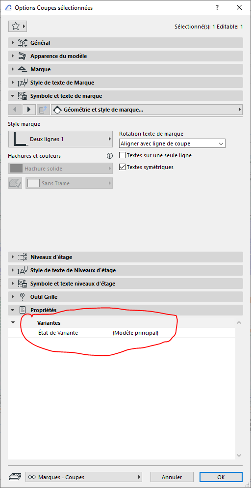

Hi Marianadem,
Did you create "Design Options" and set the section "Properties" to a hidden one ?

Hi BrunoH,
That's exactly what happened.
Problem Solved!
