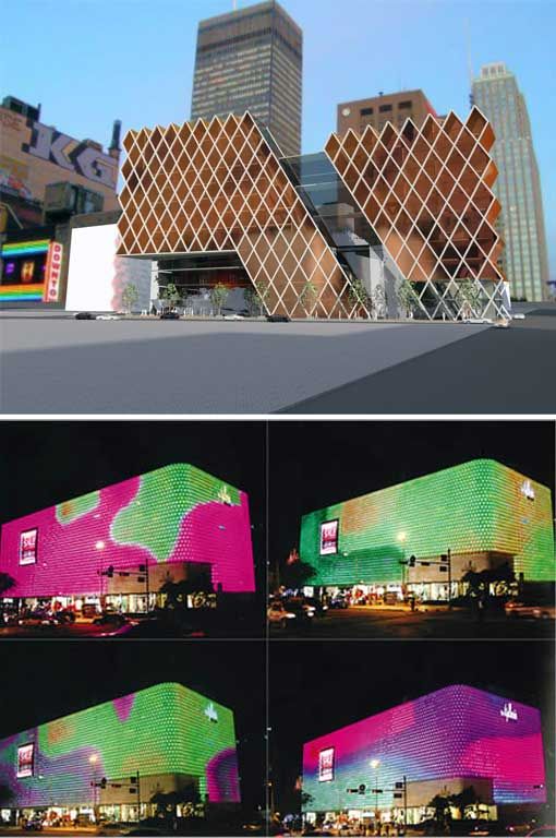

I am trying to do a nice night render, but can't seem to figure out the best approach. My building is 12 stories, with2 types of glazing, one of which should more or less "glow". How should I do this? It seems a bit redundant and overkill to add and duplicate so many individual interior lights.
How do you recommend to approach this?
Attached is an image with my building (day render) and an example of the kind of light I want to achieve

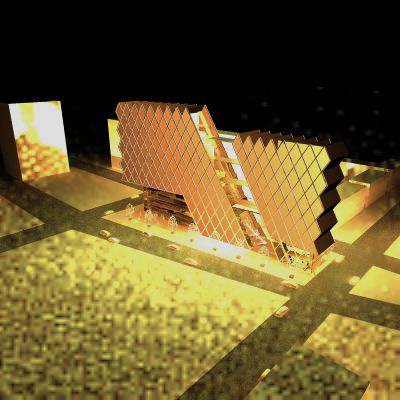

Cant seem to get it right...and how can I reduce all that splochiness?
Dwight
Reduce the radiosity.
Post your settings.

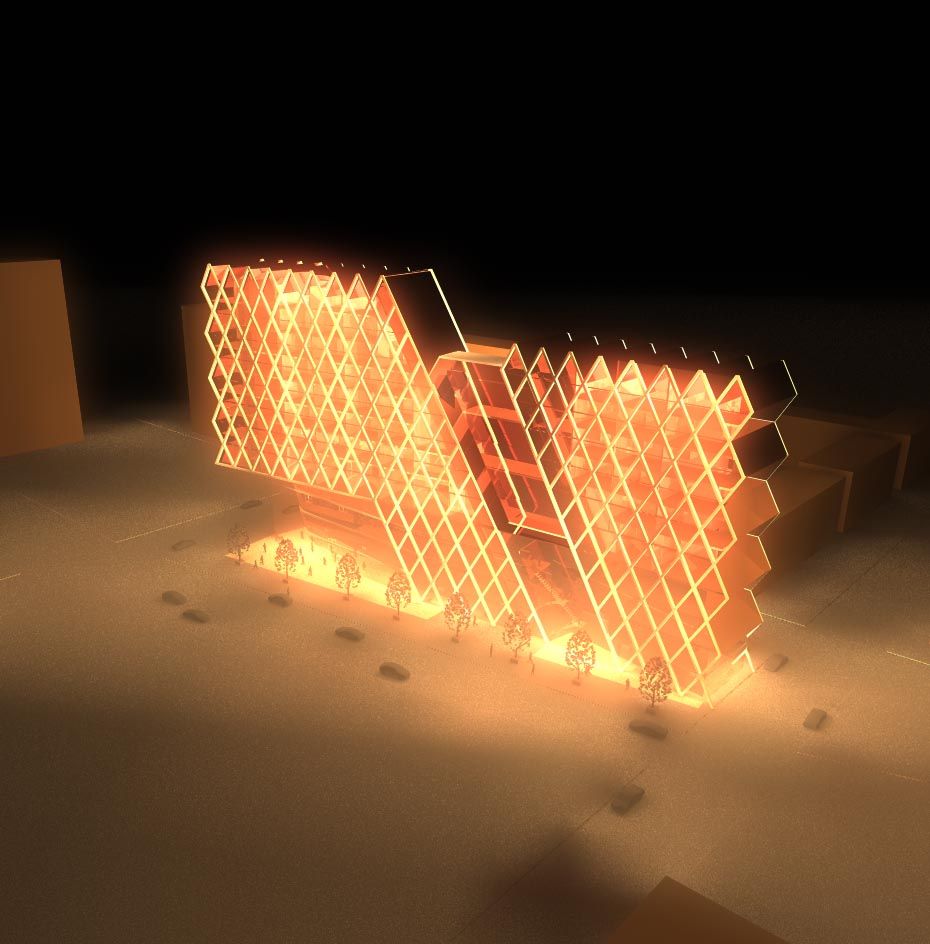

Dwight
Those students! Always changing their minds! As bad as bosses!
Lot of changes: this is all glass - neon glass
Worked the mullions
And the ground, the cars, etc....
Dwight Atkinson
Dwight
Here's the final view in context.
Seems a little dreamy - trying to hide there not being anything in the building....
and twenty minutes work / 2 minutes rendering once we knew the objective AND one light - neon glass....
