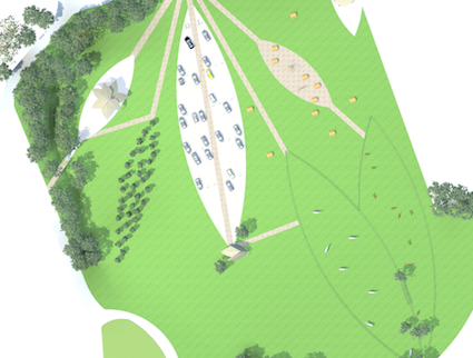

I want to render a plan view of my site which is 70% grass and trees. It will be a parallel view so shading is needed to add depth to the trees etc.
I've added a postcard (default) onto the lawn but nothing appears to change when I render it. Also, when I select the parallel view, my render/view window is completely blank. I don't see anything in the camera view dialog nor when I pan around.
I'm very new to Artlantis and any help is greatly appreciated... deadline tomorrow
Thank You
Not that the attached is for reference, I hope to use a parallel view when I find out why it's not working for me.

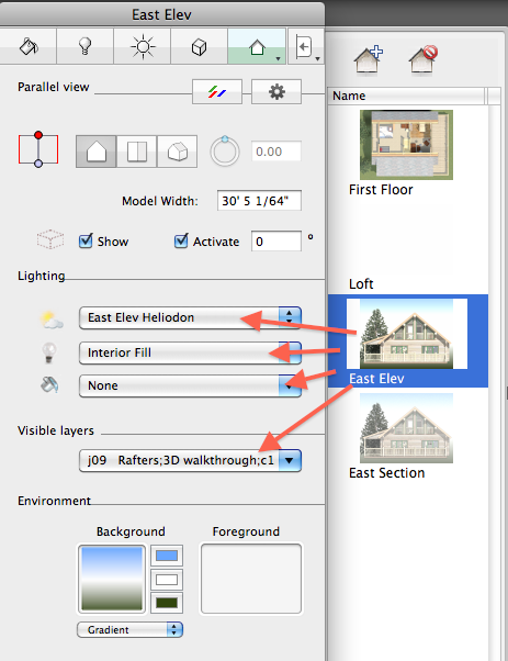

The parallel view issue is because each new view of any kind has its own associated sun/heliodon and light groups. No doubt your new parallel view did not have any lighting selected. You can simply select the same heliodon name as you are using with your perspective view if you want to use the same time of day/etc.

I got it working! I think the parallels didn't show anything because none of the layers were turned on...
I've rendered, again the grass looks very poor, I've used the dafault lawn postcards...

Add a new heliodon in the Heliodon inspector as shown in the attached.
Karl Ottenstein
Moderator Emeritus
Set up your parallel view as shown here - Artlantis Views have a similarity to ArchiCAD views in that different settings are associated with each one.
So, select your view in the tray (East Elev in my example), then select the appropriate lighting and visible layers.
