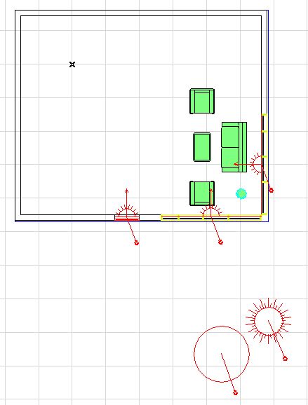

Here's my 2D Layout.
Does it make much of a difference how high the sun object is off the ground???
Does it make much of a difference where you actually place the sun object in the drawing???
Or is everything controlled by Azimuth and sun angle???
Thanks

regarding render time - that is way too much - you have got your sun and sky object resolution set to the maximum, I bet, try backing off to half of what you presently have. These number are exponential.
