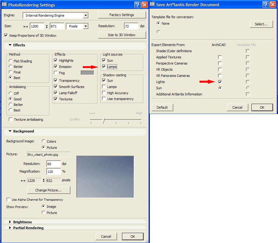

i can't export my lights from the AC 3d view to the artlantis 4.5
this option is turned off anyboy has an idea?
Before you save the Art•Lantis file, go to Photorendering settings and check the lights as the light sources.

gobel wrote:
it doesn't work, i had to open an old file delete everything and merge this file to the old one so it can work!!!
do you have a normal solution
Hm ...
Did you set the Photorendering in ArchiCAD as attached?
When saving ATL, did you set the export as attached?
If the answer to any of the above questions is NO, that is why it does not work

Ok i got it, the problem that i was using lightworks engine, and that's why it was not activated on the internal engine.
Thank you it's working now.
