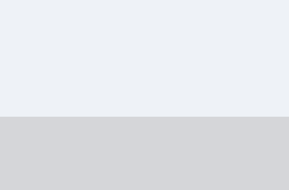

In both cases I was saving to the same folder on my local desktop. The files were saved from teamwork, but each has only the background. See example enclosed.

I don't have anything I could recommend you to try.
I will report this to GRAPHISOFT.
R Muller
Thank you. The workaround is to do all the rendering outside of Teamwork.
