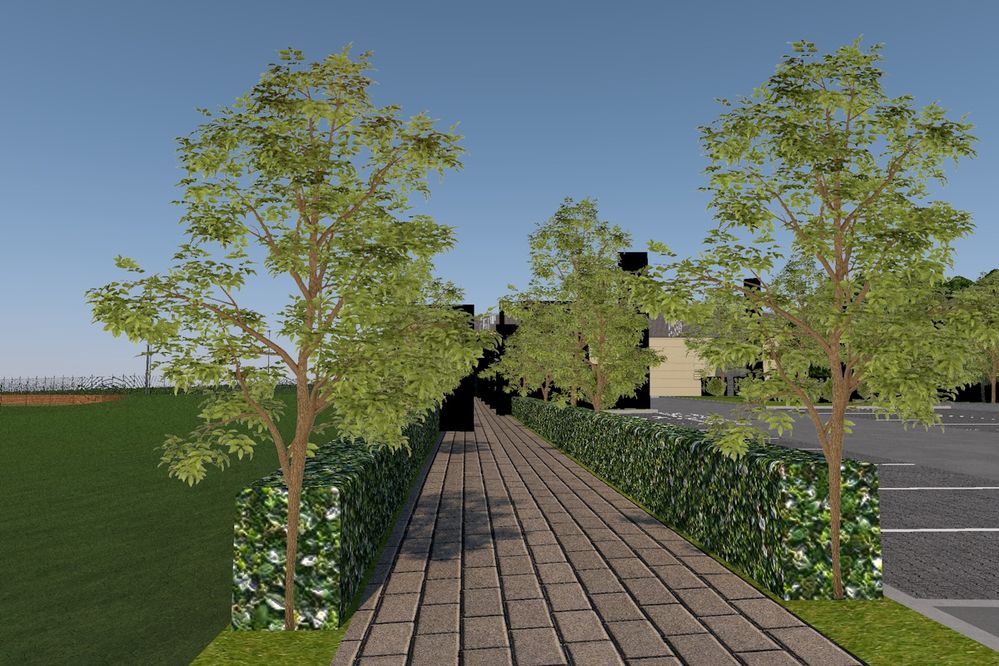

Does anybody else have this issue or know how to fix it?
I render out in AC18 in a pre-set daylight fast mode and the trees square invisible edge sometimes come out black like the uploaded file?

Another render from the same file

Answered by Marton Kiss here:
http://archicad-talk.graphisoft.com/viewtopic.php?p=233352#233352
There is an issue with CineRender that requires using the Physical Render mode with these objects.
