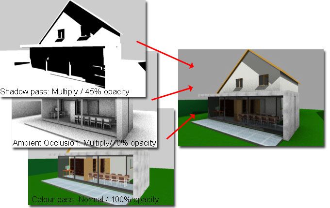

1 - Create a shadow-catching material, by using the Shadow Catcher shader from http://savards.fuzehost.com/shad_detail.php?ArticleID=3 in the Luminance channel (disable all other channels). Use it instead of the Ambient Occlusion shader on the copied geometry.
---> Render this pass as "Shadow-only"
2 - Create an ambient-only light, 100% white, enabling the "Ambient Illumination" and "No Specular" options. Hide the copied geometry and show the regular geometry.
---> Render this pass as "Colour-only"
3 - Reuse the "Ambient occlusion" pass.
4 - In photo-editor:
---> place the Shadow pass on top, multiply, 45%
---> place the Ambient Occlusion underneath, multiply, 70%
---> place the Colour-only at the bottom, normal, 100%.
Voila, you can still tweak the balance in realtime, without re-rendering.
