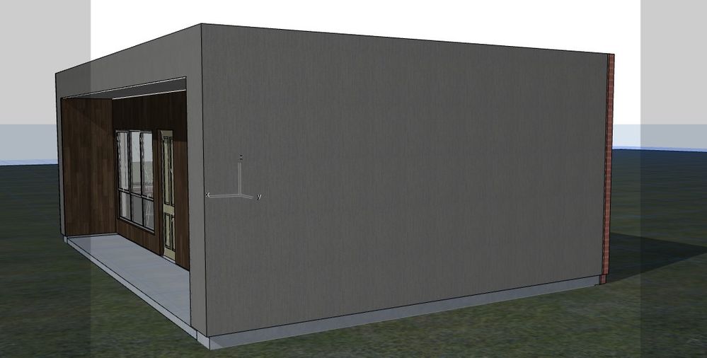

HI,
I can't render in 3D, CINEWARE keeps crashing.
Also, I downloaded a .jpeg of a material surface and created an new surface (please see attached). (cement sheet)
In the model when textures are turned on it looks great. But when I rendered it goes a spongy  yellow colour??
(this was before Cineware was crashing.

hevi
Ace
The 3D window uses the basic engine which have different settings than the Cineware engine which likely is why you get a different result. The Cineware engine is more advanced and requires some knowledge to get a good result when creating surfaces.
What are your machine specs, in particular your video card?
Have you updated video drivers?
Have you tried rendering just a single wall or slab - something very simple?

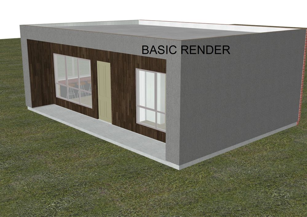

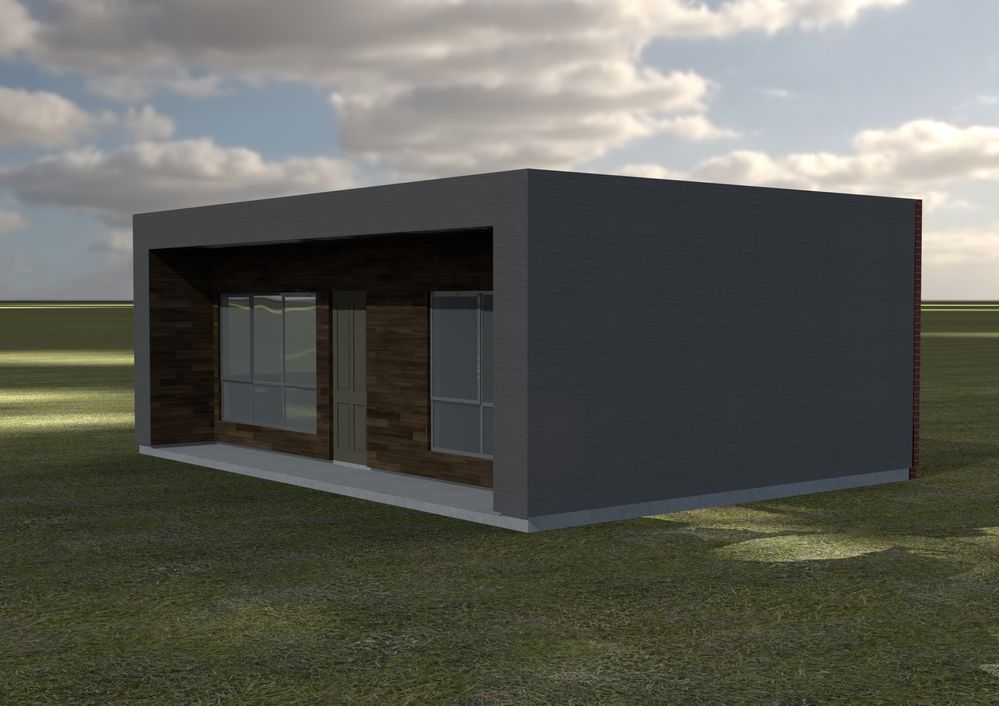

cadsph
I got into photo-render settings & manged to get it working,
I've uploaded an image of the yellow texture from the .jpeg.
when I use Basic render it comes out the right colour (graphite).
Does anyone know why the texture turns yellow?
220526_STUDIO PROJ (8-07-22 8PM) - Picture2.jpg220526_STUDIO PROJ (8-07-22 8PM) - Picture3.jpg
hevi
Ace
Try using the Match Settings > Update Cineware and see if it gets you a decent result.
cadsph
Excellent! when I changed Engine to Cineware - I updated
the match settings from basic & it worked!
Thanks.
