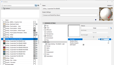

Hi all.
I am producing White Model renders, but for some reason the 600x600 Suspended ceiling doesn't render the bump or displacement...
The carpet shows displacement...
I have created various material setups, alpha channels, a few tutorials, etc, but nothing. It's just smooth.
I would like to show the grid of the tiles...
Any ideas?

johanSR
It turns out there was another slab over this one on a different layer which influenced the material...
I moved the slab on the other layer down by 15mm and it worked...
URRGHHH!!!
Simple solution, long problem searching...
