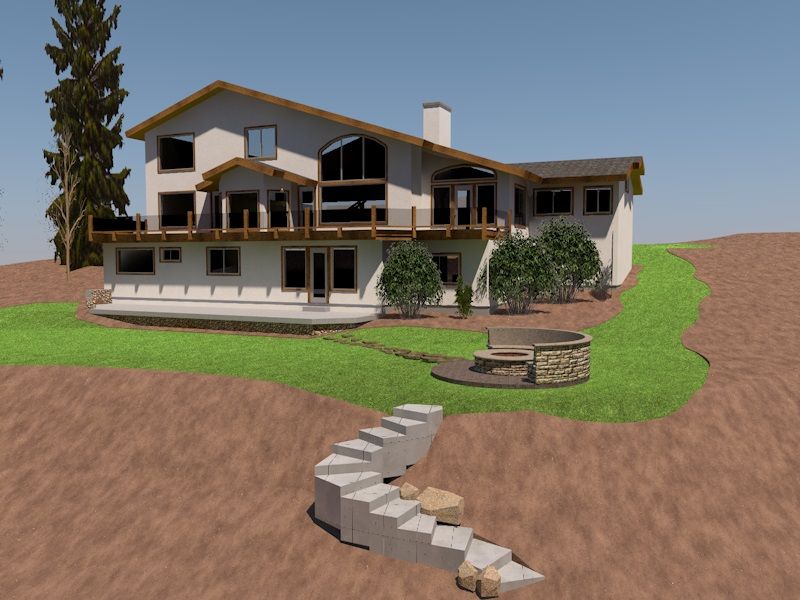

When creating a PhotoRender using CineRender the placed Pine Trees 18 & Deciduous Trees 18 objects are forcing the walls to be transparent. See Attached.
I can not find at this time were to turn the Glass transparency OFF for the PhotorRender. Can transparency be turned off for the Glass of do I have to place a different glass material in my windows?

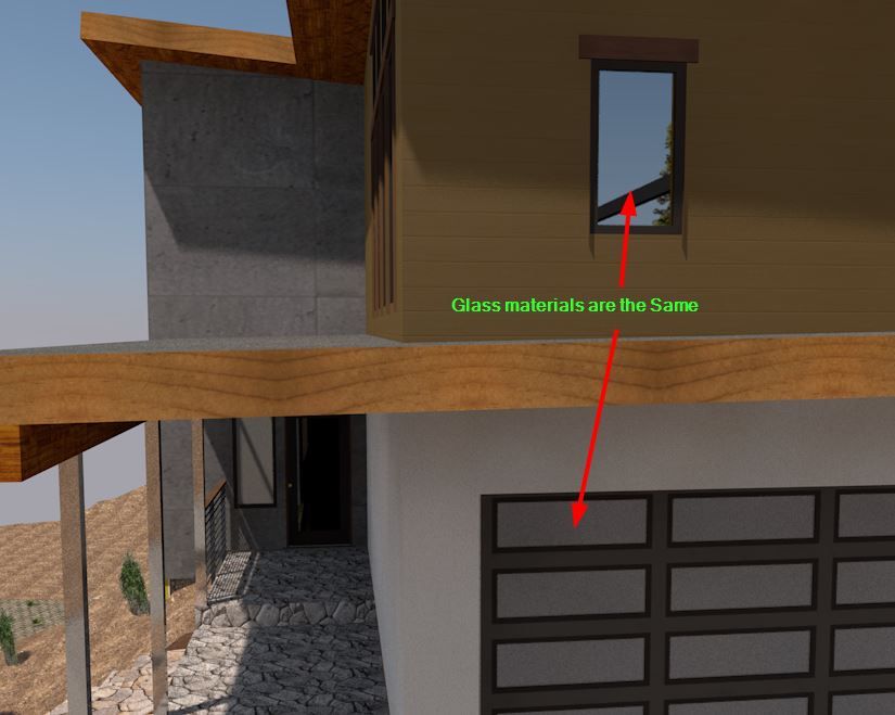

I made a Custom Door Leaf and used the Glass - Clear material for the Glass. This is the same glass material used in the windows. In the OpenGL 3D view with Transparency ON, the glass in the custom garage door and the glass in the windows is transparent. when a PhotoRender with CineRender is created the Door Leaf Glass is opaque but the same glass material in the windows is Transparent.

It is not the tree objects that are causing the roof to show transparent, it seems to be the Windows.
Does this help?
