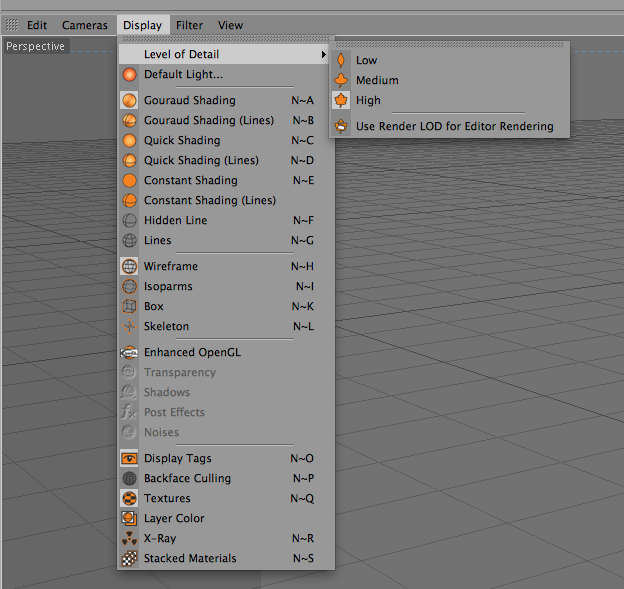

    I use 'gouraud' shading set to a high level of detail and no problems
    I use the interactive render region tool A LOT (you can adjust the quality of this interactive render as well - to speed it up)
