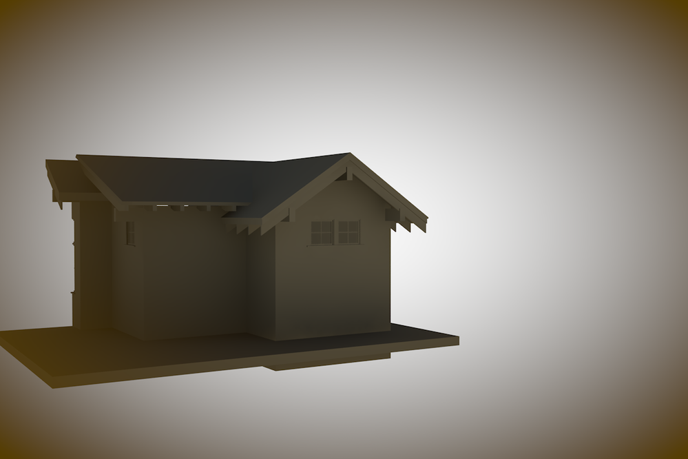

Cinerender newbe here. Am fiddling with scenes and the outdoor white give me really dark results. I am pretty sure Graphisoft would not intentionally set up default this way so am assuming I am setting up or not setting something up incorrectly. Odd that the sun settings don't seem to have any effect.

OK, duh,
figured it out. Turn off the detailed settings. Must have done that by mistake early on, then select Use ArchiCAD sun position.

Also, that image you posted has those dark corners because of the Vignetting effect.
If you still want to use Detailed Settings, you can turn off the Detailed Settings\Effects\Vignetting checkbox, plus check the Detailed Settings\Environment\Physical Sky\Time and Location\Use ArchiCAD's Sun Position checkbox.

Thanks Laszlo,
I don't really care for that effect so will turn that off.
