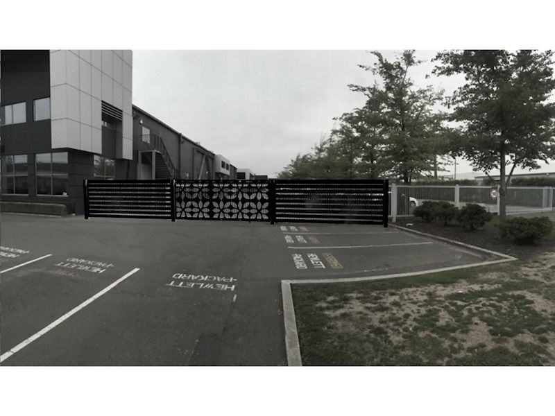

Hi
I am trying to render a gate proposal over an existing image but having little success. The gate is black but should be white. Please see image attached.
Thanks

David Maudlin
Rockstar
Pete at Walker:
Check the gate's Surface Settings > Engine Settings : CineRender by Maxon, they may not match the Internal Engine settings. To start to get them coordinated, use the Match Settings...: Update CineRender Settings (from Internal) option.

Thanks for your reply David. I have checked the surface settings and they're fine. When I render without the background image and select a sky setup under environment the surface is correct.
Should have a signature now - than ks for the tip!
Hi, could probably be lack of lighting?
Try adding a light nearby the fence and see if this change something.
Thanks that worked!
