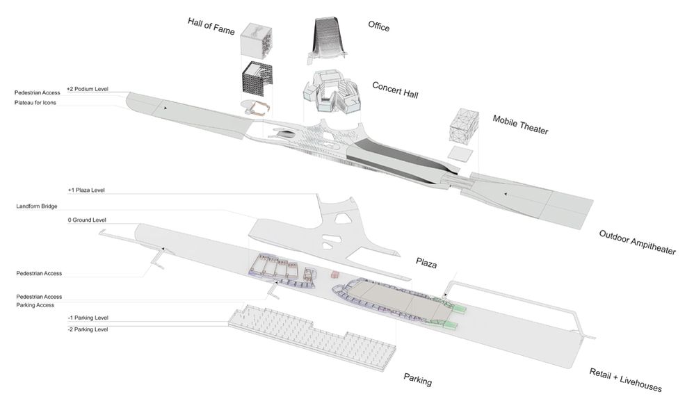

This is accomplished by saving multiple 3D-Documents (one per different element) and organizing them in a Layout. It is not one drawing but multiple ones.

OK, but how could I get just if I choose this one in the middle called Plaza?

kraljlavova wrote:If you have a separate layer for the plaza then just leave that layer on and save the 3d document just like what eduardo said. Or you could select the plaza elements in plan, and right click and choose "show selection/marque in 3d". You would do the same with all the other elements and bring them together in a layout and add additional lines and labels to them as necessary.
