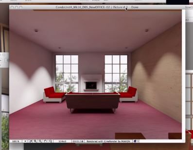

Here is what I would like my rendering to look like. I have included an image as an example here.

Courtneyb0316:
If you have any Lamps beyond the ones that can be seen in your screen shot (the pendant light and ceiling downlight), for example General Light 19, try turning it off, it may be so bright it is wiping out the other Lamps.
