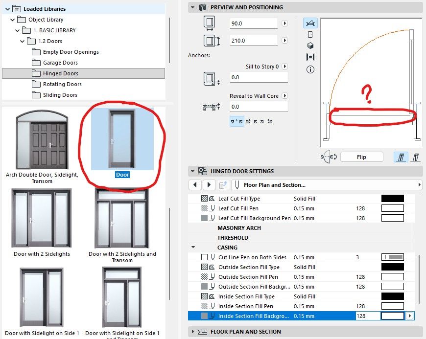

I'm trying to update some doors/windows to my Archicad 28 tempalte and I came across this ishue.
As I set the desired option for a simple door, I am left with a floor plan view that has a extra line. I can't figure out what that line is or where it can be configured (eliminated). Please see atatched image.
Can anybody help?

I have seen this before - you need to turn off the "Glazing Line" option for Doors/Windows in the Model View Options Dialog.

Did you configure a threshold for this door? That might be the one showing up in that position:

I don't currently have a project with the INT libraries loaded, but is there an option for 'center' or 'inside frame' on the wall contour line settings? or something similar?
also, check your on screen view options; could this be the wall reference line?

Gabor Szelei
Thanks László, I was also pulling my hair out because I couldn't get that line to disappear. In the end, I put a solid white fill on it 😉

Good that it can be turned off, but shouldn't the glazing line follow the door sash?
