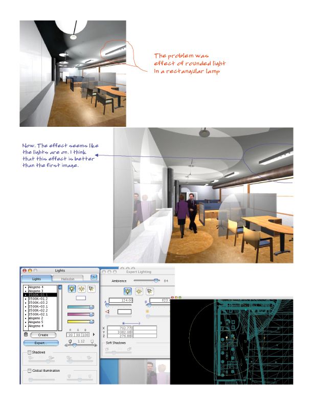

How can I make the efect of light in a rectangular lamp 3500ºK for office? for example, if I´m working on archicad I turn on the lights on settings. Now on artlantis/window/edit lights there are 3 kinds of light but no one fits on rectangular light. Does anybody knows the trick?

You will fake the light with a glowing surface that doesn't cast light at all - creating the fluorescent panel - say, the neon shader.
Then put a 3500 degree omnidirectional light on its face - or a wide floodlight if it is recessed - and adjust the start/end of the light force to not overexpose the ceiling.

Dwight, I appreciate your tips. but I found other way for the lamps of 3500K I have placed two center omni light one in each end. and I have created the wished effect, just inceasing the intensity of light.

Dwight
Can you please post your result?
Dwight Atkinson
For the lights from the aisle of the picture (right) I cant make a good effect of light I´m trying increasing and decreasing the inscidence of light, on expert lighting, I hope somebody help me with this
