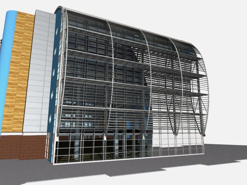

I have modelled a building with a fair amount of glass and I am wanting to create the effect of an environment map in the glazing so that I can have photos of the context reflected back in the glass - ie buiding X reflected in the west elevation and building Y in the south.
I have played with assgning a mapped material to a glass material's colour, however this falls down when the material actuall reflects and then ignores this colour (see image where reflection takes over and the glazing material's colour is ignored in favour of a raytraced refkection). Ideally I would like the image in the raytraced reflection to be my environment map (and for it to reflect differently on different elevations)
This would be the case of assigning an image to a diffuse channel in 3ds Max of an environment map, however I need to achieve something like this using lightscape.
Cheers

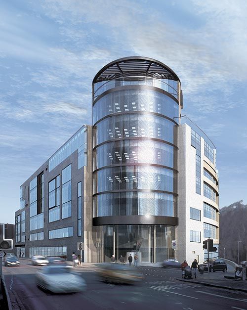

a simple solution is to reduce the reflectivity of the window material you have mapped your photo to. another is to create a billboard to provide the reflection.
Dwight
Make a big billboard across the street.
Make a material the size of the billboard of your context photo.
Make the context photo ripple to emulate glass irregularity.
Make the material coating the board have constant reflectance.
Dwight Atkinson

Ben is right, but of course the background photo won't have adjacent structures in it. Use the simple solution if you don't need precision.
Not that the context photos will either, unless you've followed my site photography protocol. They are making a television show about it: CSI.
Context Shot Investigation. Get all the details from the getgo. Use a tripod.
Billboards let you precisely position prominent things like spires (as in my example).
Of course, using a constant refletion material defies shade if the billboard face falls in shade.
