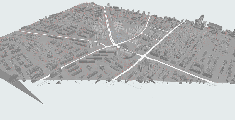

How to fix the 3D view display to the normal state? For now, whenever I navigate closer to the model, the visibility of all of the models becomes "transparent". In other words, the closer I get, the more of it disappears. I attached a screenshot of the 3D view display for better understanding.
As I investigated, I understood that the problem is rooted in the fact that model space has 25k imported objects (which are custom, non-Archicad curtain wall elements, like mullions, frames and etc.). However, turning off layer display with particular objects included does not solve the problem, which is weird. Feels like software resists pixelating a scene, no matter if those objects are visible or not. Vectorial 3D style gives me a working display, but I seek to use the regular, Simple Shading 3D style.

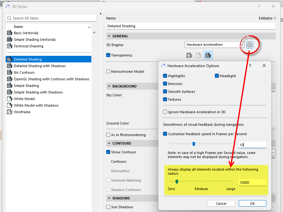

There are settings that affect what you can see.

Regarding on 3D styles settings: isn’t that setting option opposite on what I get displayed? For instance, I get visibility of most far away obejcts while most nearby are cut out.
