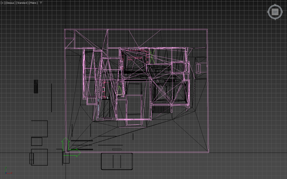

The previous datasmith fbx exporter create clean geometry, the actual FBX exporter triangulates all faces,
Any solution to have clean geometry , it's impossible to work with such model in 3ds max.

the screenshot shows the result of the native FBX format from Archicad 27.
since Archicad 24 , the old FBX ecporter provided by epicgames is not available, that exported creates clean geometry ,
the fbx exporter for Archicad 27 create triangulated geometry.

yes , it's an editable mesh , quandrangulate modifier did not remove triangulation.
