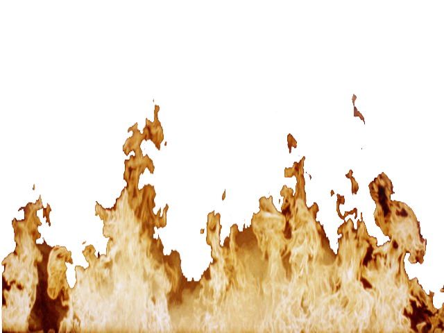

1. Is it possible to use billboards instead of walls, why do you use walls.?
2. The "fire pictures", I thought it is was nesserary to use a file with alpha channel..?
3. The customer wants a glass panel in front of the fire place from both sides, is it possible to make it some other way, so the rendering still looks ok.?
4. I have one picture of a fire, se the attached file. It is with white color around the fire. The picture has to be transparent around the fire right.?
Martin
Dwight
We use walls so the fire image can be sinuous and irregular.
You need to learn the masking/alpha channel function in a photo editor.
This fire is too active for a fireplace. This is not a calm, sit-by-the-fire-with-your-sweetie fire, it is a die-witch-die fire. You can easily mask the white to transparent in a photo editor.

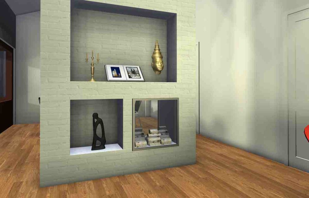

I have found a picture which I thinks look ok. Without doing the things you told me. See attached file.
I will try to make a fire like you told me, so I can se how big a differens there is.!
It is as you know, a little more hard work to do it the photoshopic way...
Your are welcome to post your comments on my rendering..!
Martin
Dwight
Floor board pattern obviously repeats. Make individual boards with about four different darknesses.
Horizontal grain on doors and windows. Archicad problem - make a 90 degree rotated material.
Typical lightworks scene lighting have vague blackness, unearthly greeniness and icy blueness. Add more color to lights. Add general brighteners to reduce blackness in shadows.
Fire is flat. Recess it into the opening - make it a constant reflectance surface to avoid shadow.
Strange, empty floor space near red furniture? Is this a house or a showroom?

I have one light cone upwards with a light yellowish color in the room. And then I have several window lights with also light yellowish colors. On the windows, and also inside the room in different corners.
The general light, is that the yellowish color, or the blueish to give the best result.?
Yes I have a big space in the middle, I think I need a chair or something there.!
And yes it is a a house and not a showroom.!
Martin
Dwight
adding yellow is the ticket.
