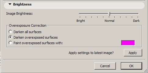

It is not easy to diagnose your problem but you can start with those:
1. Check if you don't have a fog in your foreground settings
2. Make sure the image brightness is at "normal" level
and here..

You are of course right, setting everything to 100% isnt the way to achieve the best renderings - the settings i've shown above were me trying everything i could think of to try and get rid of that foggyness... but with no avail.
I'm still stuck as to why the image changes at the end of the rendering, any further thoughts?
-Go back to last tab- Brightness
-Check last radio button- paint overexposed surfaces with
-Change colour to pure white
-Click on apply button
