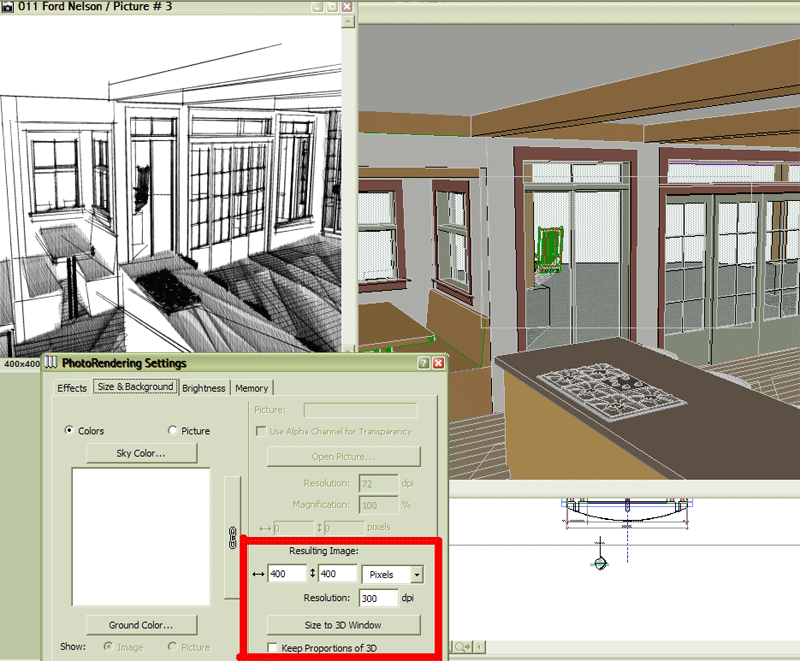

This weekend lead to some extended time with my sketch rendering engine and some new (to me anyway) revelations that I felt were worth sharing.
1] The settings of the sketch rendering are significantly influenced by the size & background field in the photorenderings dialoge box. I had been having unusual results from time to time and was unaware why.
By checking the size to 3D window and keep proportions of 3D window, even if you later change the size of the rendering output your "sketched" perspective lines stay appropriate, or rather in perspective. Without making these adjustments some rather undesirable and unusable results ensue. (see attachments)
2] Having my client ask for some higher resolution (read larger) format renderings the same settings for the lower resolution sketch renderings seemed, well light. I then began playing around with the line weights across all fields of the sketch rendering options and achieved the results I was after.
Simply put, if you are intending to output large format sketched renderings increasing the line weights to suit your tastes will yield similar looking results to the lower resolution or smaller output renderings.
Not rocket science but if I had had someone "splain it to me Lucy" as I am doing here my Saturday would've belonged more to me.

This is quite a significant find. Well done! I've seen these stray lines only too often, and now I know why. Hopefully GS has seen this and will fix it in the next version of ArchiCAD.
Nice tip on the line thickness too!

Good info, Jeff. Thanks for sharing. This seems like a good thread to re-post my tip from January 2003 on the old escribe list for saving custom Sketch settings...

Try the 'air perspective' setting - pretty nice effect: it fades lines in
the distance the higher the value.

You'll notice the 00 W3D heading under sketch styles in my attachments...........although it took Link a couple of emails to get me pointed in the right direction. But once you've got it the sky's the limit.
As I have mentioned before the sketch engine is a HUGE leap in presentation from my perspective, no pun intended. Every step away from the "CAD-like" look I can take I will. Now like you said GS just needs to make it easier.
