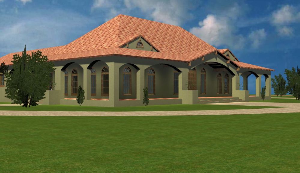

Recent graduate! Need some help. I am tring to set off the columns of the house, but try to bring attention to the front door.
Any comments would be great!

You might consider some of the things said about Neil Robinson's recent image post.
But for you:
Technical:
Your image misses using the important undersun to eliminate "Black soffit" disease on arches when there is no uplighting.
Take a sun object, make its setting manual and place it at -90 degrees altitude to create the "undersun." Shadow "off."
Compositional:
-- this image would benefit from a lower sun angle to keep the porch from being so uniformly dark, even though you have placed lighting there.
-- Never compose a scene where the front door isn't inviting, especially by putting barriers to the eye being led to the doorway.
These things are all covered in more detail on pages 27-36 (Quick Start Guide) of the book "LightWorks in ArchiCAD."
(Hint - several other things in that book can speed anyone to improved LightWorks skill.)

Made the changes suggested and moved the camera angle. Do you think it is a little too bright?
Dwight
Those porch downlites are making a kind of murkiness.
Turn up your ambient to around 50 and make it yellowish.
Your skylite - turn off shadows....
