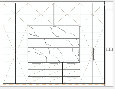

Hello! As we use LED strips almost everywhere,: every cabinetry, every builds in, every shelf, ceilings, and all,  I am looking for archicad object to add them. (ideally they look linear and they can be adjusted in thickness and lenght and represent in floor plan/elevations per settings.
Until now I have been adding them into elevations and floor plan manually (drawing lines) to indicate them but it no longer works this way for me as it's a full time job and hard to keep track on it, especially if something change, I have to adjust both floor plan & elevations manually.
I have seen many posts about led strip lights, but the problem is I can't find any object in archicad library or CI tools library.  I tried searching led light, led strip, strip.... and nothing comes out.
Below is how I need them to look (I really mostly care just to indicate them) are and I need this to be a light object so it reflect both in elevations and floor plan as per settings.

why not use a beam with the proper measurements? it will even give you the dashed look you need.  i would put them in their corresponding layer too. you can even label it, but specially and i cannot emphasize it enough, youll avoid drawing things in 2d.
A complex profile beam, so that there is no way you can mess up the section, can find-select by profile name, can modify the profile as needed, and if you are particular about it for rendering or whatever purposes you can use a segmented beam with fixed-dimension end segments.
Or if you want to avoid any possible interaction with walls-beams-columns, a railing element with just one rail.

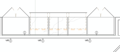

That is correct, you can use beams or railings as linear light elements which will get you the exact look you need according to your images with the added benefit of annotation, scheduling and even rendering. You are currently using 2d linework, so whats the difference?
what rendering engine are you using? you can assign a light material to them so they can throw some light

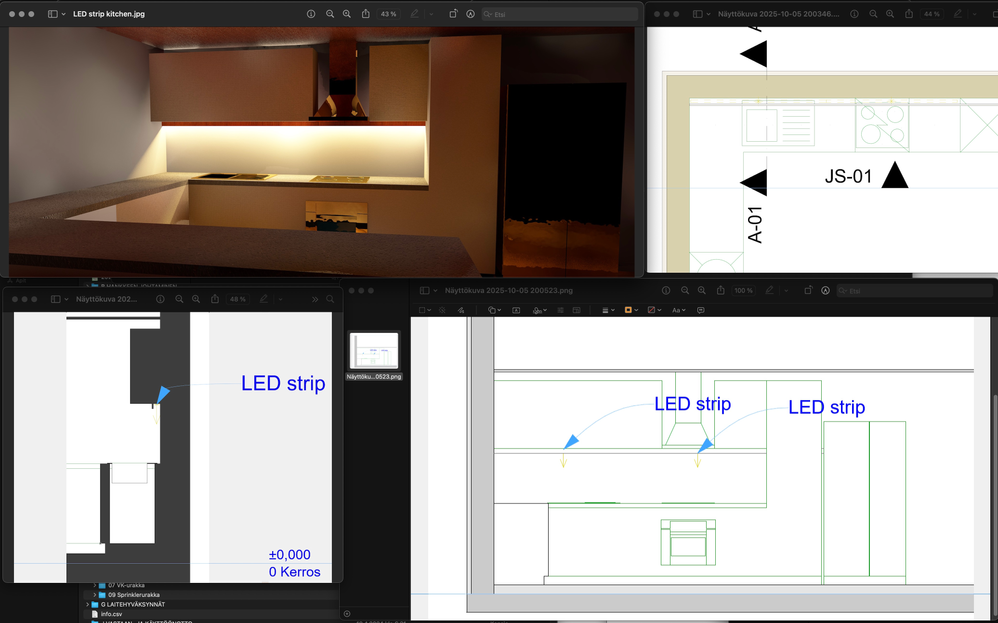

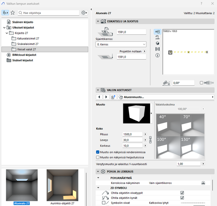

mikas
Maybe you could try Area Light and use a shape of the led strip as it's 3D form.
I use area light a lot in renderings, but maybe it could serve you in 2D projections taken from the model. I can't say for sure.
