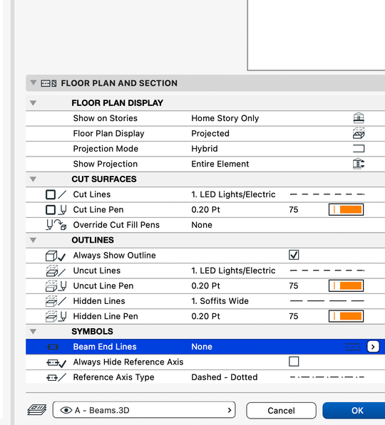

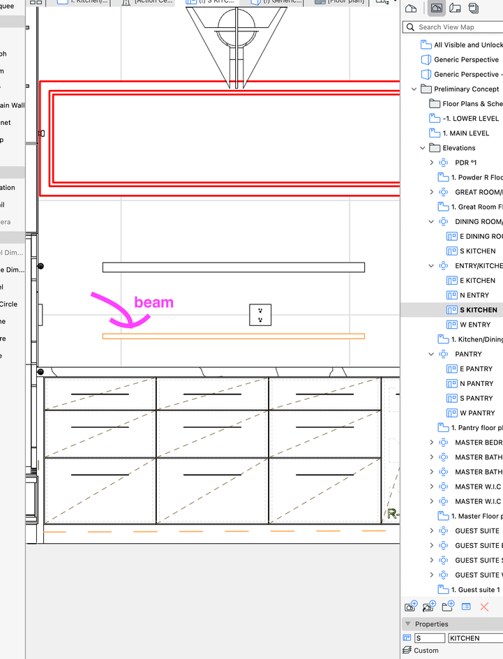

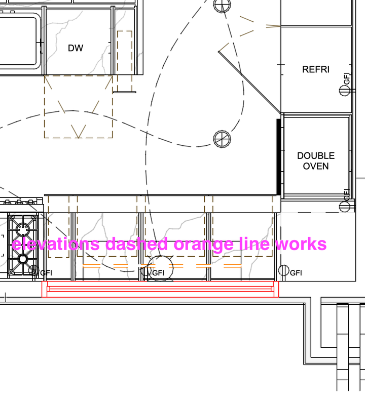

Hello! I have tried the beams! howeverrr! the aesthetic setting. I have set it up that both floor plan and elevations shows the dashed orange line. It works ok for floor plan but in elevations it shows solid line instead. I checked elevations setting view, model views, and I have no overrides are on.
 Could you share if you have some magic setting that could show the beams on elevations dashed instead of solid?

Patrick M
I almost always only need this for plan views; so a line type is sufficient. if a 3d object is necessary; it would be very simple to script a cube or even just model/save as, or use a beam (complex profile if you really need it to be LOD 350+)
Elevations are just axonometric 3D views, and there is no such thing as dashed lines in 3D.
So if you are using a beam to represent the lighting strip, you can not show it as dashed.
You would have to place a separate dashed line.
Or you could script a lighting strip object and that would allow you to script a dashed line in 3D.
Which is actually a trick of dividing the entire line into short lines with gaps.
But if you are not into GDL scripting, I would just add your own dashed line in the elevation.
No, it will not be linked to the light object/beam, but at least you can easily represent what you want to see.
