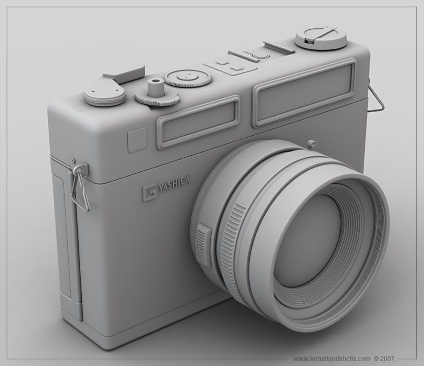

Is there a way to get this kind of "clay" or "plastic" render out of Artlantis or ArchiCAD? I know the bigger programs, such as 3DS or Modo can do it with global illumination...didn't know if there was a way to do it or not.

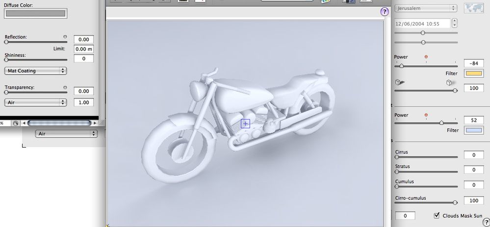

Heres my first attempt...fairly close to what I was hoping for. My only issue is the shadow "rays" from so many lights...any idea how to smooth that out?
Dwight
Here's a variation on the absolutely neutral solution.
And I made the surfaces quite grey.....
As for shadows in your valleys - maybe you could make the surfaces glow slightly?? Are you sure you have turned off the shadows in the heliodon??
Dwight Atkinson
Heres with the same settings minus the post-processing brightness, which is doe in photoshop instead...
I actually turned the heliodon off for these..it was giving me a far too bright and sharp image, even with power all the way down and softest shadows.
I think this one is very close to what I want...Ill be able to know better once we get our project massed and in here, close up.
This is clay render . . .
