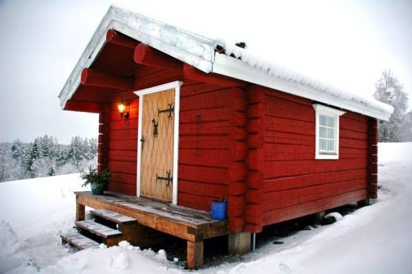

I haven´t been working so far with Archicad and have a quetsion concerning external walls. Ho do I get a surface as a timber wall on the house like the attached picture. I didn´t find any of this on the models in wall settings? Do I have to download or what? I
Grateful for help

It's easy to model such building using profiled walls.
If you specialise in this type architecture look here:
http://www.mad.fi/mad/logs.html

And there is the built-in log wall tool.
